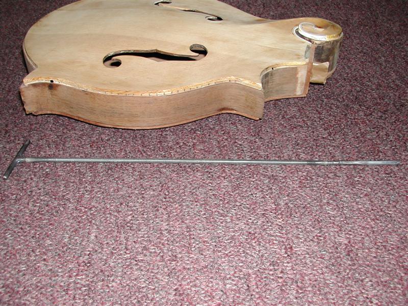

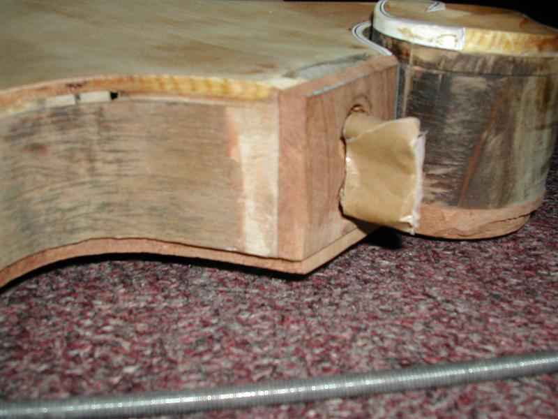

I have a mando that uses bolts and a butt joint. Just use the end pin hole to get into the body to tighten the bolts. Before putting the back on, just put the bolts in and fit the neck. Put some tape on them to hold them in. Then attach the back. To put the neck on, use a long T handle with a allen wrench soldered on. You could probably use a wooden dowel with an allen wrench epoxied into the end of it. There are multiply ways around it. Good luck!
